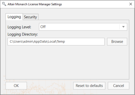

To modify the location of log files and the amount of information found in these files, click Settings on the upper right-hand corner of the License Manager.
The License Manager Settings dialog displays.
Using the drop-down provided, select a logging level using the following table as a guide:

You can also select a new folder in which to store log files by clicking on the Browse button. Doing so launches a Select Folder dialog that you can use to specify a new log file location.
