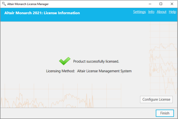

In License Manager, select the Connect to an Altair License Management System option in the Choose License Method screen and then click Next.
The Altair License Server Connection screen displays.
At this point, you can activate your Monarch install in one of two ways:
Enter the path to a valid Altair License Server into the field provided.
Enter the path to a valid Altair License File into the field provided.
If you wish to enable license checkout (i.e., allow users to “check out” or “borrow” their license so that they can work with the Monarch applications offline), enter a maximum number of hours users can check out their license into the Advanced > Borrowing Duration field.
Click Connect when you are done.
Monarch is successfully activated.
