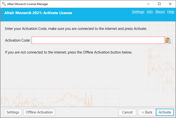

Activating Monarch using an Activation Code
You Activation Code may also be referred to as your License Code, License Key, or License Number.
This is an 18-digit code that you need to enter to activate Monarch.
Example:  993600-000215-542441
This key should have been provided to you if your copy of Monarch was properly purchased.

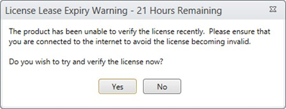

When a license lease (i.e., the time between two verification instances) is about to expire and no internet connection is detected, the following message displays:
If you wish to verify your license, ensure that you are connected to the internet prior to clicking "Yes" on the dialog.

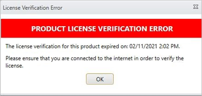

If your license expires and no internet connection is detected, the following message displays:
To continue using Monarch, simply connect to the internet to verify your license.
If an internet connection is not available, contact Altair Support.
