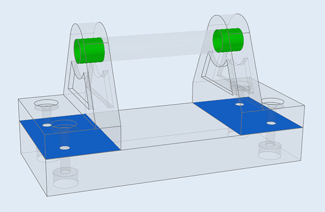

Figure 1. Model with Contacts Defined
Defining Surface Contacts
Find neighboring surfaces and designate whether they should be bonded, contacting, or have no contact.
Select the Contacts tool. Contact detection begins
automatically, but can be stopped by clicking the Find button. Bonded contacts
are shown in blue; contacting in green.

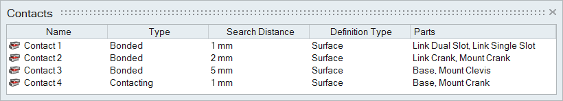

Contacts Table
The Contacts table lists all of the contacts in your model including the type of connection and the parts it connects.
Click the satellite icon on the Contacts tool to display the table.
The Search Distance listed in the Contacts table shows the minimum gap (the exact minimum
distance between the two parts). The search distance for an individual contact defined in
this table will override the global Auto search distance defined in the Find Options on
the guide bar.
The table data can be edited with the following actions:
To | Do this |
Rename a contact | Select the cell in the table and then click again to make the field editable. |
Change the connection type | Select the cell in the table and then select a different option from the list. |
Sort a column | Click the column header. Click repeatedly to toggle between ascending and descending order. |
Add or remove columns | Right-click on a column header. |
