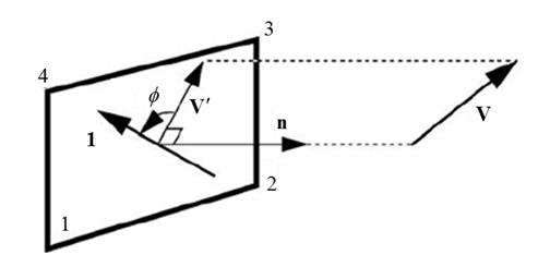

Transformation Matrix: Global to Orthotropic Skew
図 1. Fiber Orientation

Element Orientation
図 3. Fiber Direction Orientation
The shell normal defines the positive direction for . For elements with more than one layer, multiple angles can be defined.
