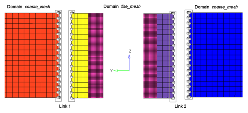

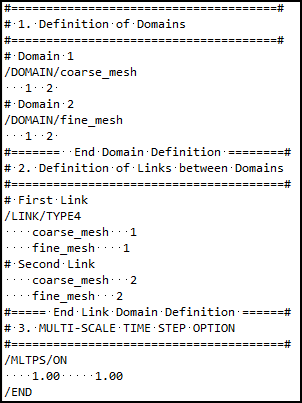

In order to run this analysis using Multi-Domain technique, we have to split this model into two domains, one containing the finely meshed region and the other containing the rest. A node to node link (/LINK/TYPE4) is then specified at the boundary between the two domains.

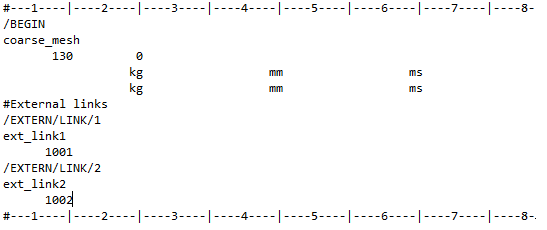

These domains will be created using a pre-processor (using HyperCrash in this tutorial) and the options specific to Multi-Domain analysis will be added to the input decks through a text editor. A Multi-Domain main input file will also be created using a text editor.

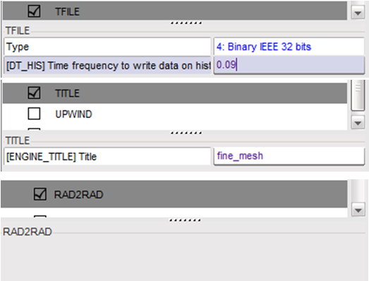

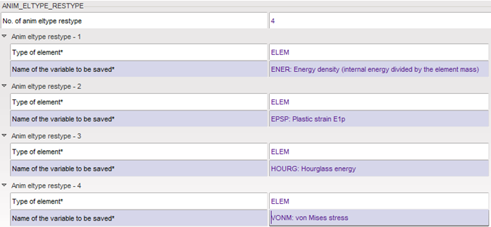

  1. Click Model > Control Card to set the Control Cards, as shown in the following images:
    rd3160_control_cards1
    図 2.
    rd3160_control_cards2
    図 3.
    rd3160_control_cards3
    図 4.

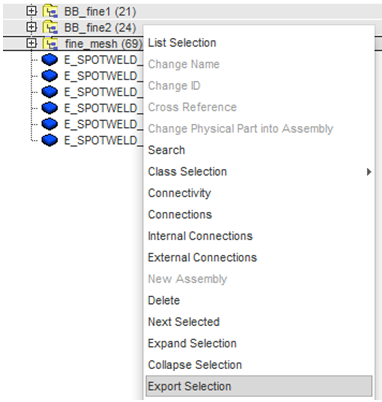

  2. Treeタブをクリックして選択します。 the subsets of the fine-meshed region (subsets BB_fine1 (21), BB_fine2 (24), and fine_mesh (69)), then right-click, then click Export Selection.

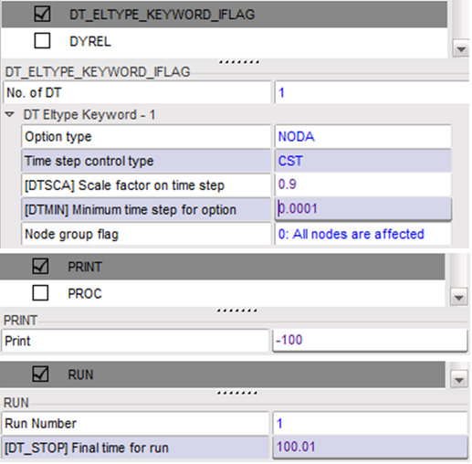

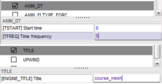

  6. Click Model > Control Card and enter the following Control Cards:
    rd3160_control_cards5
    図 7.

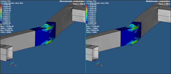

Expected Results
rd3160_results
図 12.
