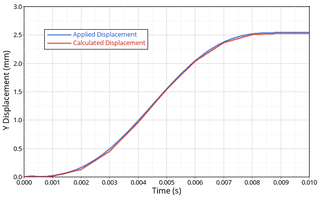

図 2. Applied Displacement and the Displacement Calculated
The calculated displacement, where the imposed velocity was applied in the y direction was 2.530 mm. When compared to the applied 2.540 mm displacement, there was a numerical error of 0.39%.
Conclusion
The contact interface friction calculation results in minimal error of 0.39% when compared to theory.
