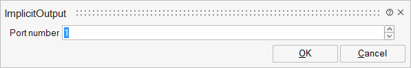

Placed in the diagram of a super block, the ImplicitOutput block adds an implicit output port to the super block for linking implicit signals inside of the super block to blocks outside of the super block. Any link, outside of the super block, that is connected to the implicit output port on the super block extends from the corresponding ImplicitOutput block inside of the super block.
The parameter "Port number" determines the relationship between the port block and the port on the super block. By default, the output ports are numbered sequentially from top to bottom.
