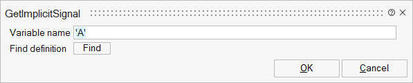

GetImplicitSignal
This block receives implicit signals from a corresponding SetImplicitSignal block by connecting the implicit ports of the blocks without using a link. A single SetImplicitSignal block can send implicit signals to multiple GetImplicitSignal blocks, but a GetImplicitSignal block can receive implicit signals from only one SetImplicitSignal block.
Routing
The GetImplicitSignal block connects implicit ports from one block to another without connecting them physically. It is used with a SetImplicitSignal block. A simple SetImplicitSignal block can send data to multiple GetImplicitSignal, although a GetImplicitSignal can receive data from only one SetImplicitSignal. SetImplicitSignal transports its input data to its corresponding GetImplicitSignal block.
For more information, please refer to the GetSignal block.Parameters
tag | Variable name | String |
Port 1 | implicit | output | 1 |
