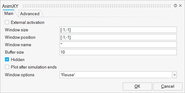

External activation
winSize
Window size
X,Y dimension of the plot window. Integer values. Default size is given as [-1,-1] and corresponds to [400,400].
Vector of size 2
winPos
Window position
X,Y position of the plot window. Integer values. Default [-1,-1] indicates the window is positioned automatically.
Vector of size 2
winNam
Window name
Name of the plot window. String. Default is empty.
bufferSize
Buffer size
Size of the buffer. Integer value. Default 10.
winHidden
Hidden
The window is hidden initially by default.
showAtEnd
Plot after simulation ends
Display the plots (lines) at the end of simulation instead of progressively along with simulation time.
option
Window options
Define the scope window setting for a simulation. Default is 'Reuse'.
- 'Reuse': An initial simulation plots results in a scope window. Subsequent simulations plot results in the same window, but any existing data is erased.
- 'Overlay': An initial simulation plots results in a scope window. Subsequent simulations plot results in the same window. Existing plots are retained.
- 'New': Each simulation creates a new scope window.
- 'Recreate': Each simulation produces a new scope window, and the existing scope window is deleted.
'Reuse'
'Overlay'
'New'
'Recreate'

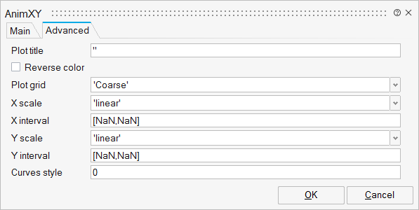

AnimXY_1
plotTitle
Plot title
plotColor
Reverse color
plotGrid
Plot grid
'No
Grid'
'Coarse'
'Fine'
xScale
X scale
'linear'
'log'
'db20'
'db10'
xInterval
X interval
Vector of size 2
yScale
Y scale
'linear'
'log'
'db20'
'db10'
yInterval
Y interval
Vector of size 2
curvesStyle
Curves style
Vector
