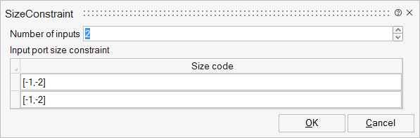

This block adds a size constraint to the model.
SignalProperties
This block imposes size constraint on all input signals to force the same or different sizes. Negative numbers in block parameter "Input Port Size Constraint" are used to represents the size. For example, when the types are defined by -1, -1, it means both input signals should be of the same size. When sizes are defined by -1, -2, -1, it means the first and third input signals are same sizes, the second input signal is a different size.
nin | Number of inputs | Specify the number of inputs of the block. | Number | |
in_ports | Input port size constraint | Structure | ||
in_ports/szx | Size code | The desired sizes. Use negative numbers to represent that input ports have the same or different sizes. | cell of matrices of size 1x2 |
