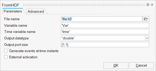

FromHDF_0
fname
File name
Full filename, with path, of the HDF5 input file.
varname
Variable name
Name of the variable to store the signal values.
timename
Time variable name
Name of the variable to store the signal time values.
typ
Output datatype
'double'
'int32'
'int16'
'int8'
'uint32'
'uint16'
'uint8'
'boolean'
'inherit'
outsize
Output port size
Matrix
outevent
Generate events at time instants
externalActivation
External activation

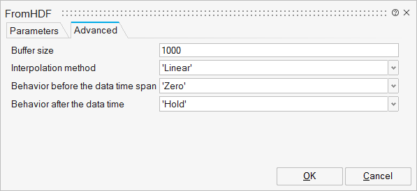

Buffer
Buffer size
Method
Interpolation method
'Zero-order'
'Linear'
'Not_a_knot'
'Natural'
'Clamped_To_Zero'
'Akima'
'Fritsch_Butland'
'Steffen'
Leftside
Behavior before the data time span
'Zero'
'Hold'
'Extrapolation'
'Repeat'
Rightside
Behavior after the data time
'Zero'
'Hold'
'Extrapolation'
'Repeat'
