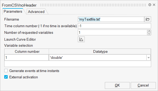

FromCSVnoHeader
This block reads data from a CSV file where the header line may or may not be present.
    FromCSVnoHeader
SignalImporters
FromCSVnoHeader_0
fname
Filename
timeColumn
Time column number (-1 if no time is available)
If no time is available, the block should be activated by an external activation. If a time column is specified no external activation is required.
nout
Number of requested variables
outports
Variable selection
Structure
outports/colnum
Column number
Cell of scalars
outports/vardatatype
Datatype
Cell of strings
'double'
'int32'
'int16'
'int8'
'uint32'
'uint16'
'uint8'
'boolean'
outevent
Generate events at time instants
If a time column is specified, then the values in that column are the times of the event activations.
externalActivation
External activation

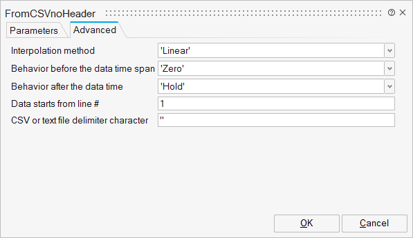

FromCSVnoHeader_1
Method
Interpolation method
'ZeroOrder'
'Linear'
'Not_a_knot'
'Natural'
'Clamped_To_Zero'
'Akima'
'Fritsch_Butland'
'Steffen'
Leftside
Behavior before the data time span
'Zero'
'Hold'
'Extrapolation'
'Repeat'
'Error'
Rightside
Behavior after the data time
'Zero'
'Hold'
'Extrapolation'
'Repeat'
'Error'
Offset
Data starts from line #
Separator
CSV or text file delimiter character
nout
externalActivation
Port 3
outevent
