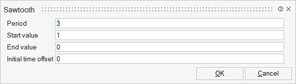

The Sawtooth block is a sawtooth wave generator. The signal is defined by four parameters: Period, Start value, End value, Initial time offset.
period | Period | Period of the signal. Scalar value. Default: 3. | Scalar | |
down | Start value | Initial value of the sawtooth. Can be a scalar or a vector. Default: 1. | Matrix | |
up | End value | Final value of the sawtooth. Can be a scalar or a vector. Default: 0. | Matrix | |
tinit | Initial time offset | Time offset before sawtooth starts. Scalar value. Default: 0. | Scalar |
