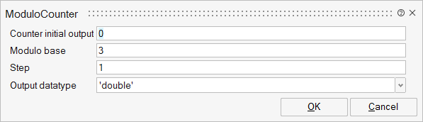

ModuloCounter_0
ini_state
Counter initial output
Initial value (scalar). Any number between -1 and base-1. The value -1 is replaced with base-1.
Matrix
base
Modulo base
Base value for the modulo (scalar).
Matrix
step
Step
The increment or decrement of the counter. When positive, it counts up. When negative, it counts down.
typ
Output datatype
The datatype of the output. Supported types are: Double, int8, int16, int32, uint8, uint16, uint32, inherit.
'double'
'int32'
'int16'
'int8'
'uint32'
'uint16'
'uint8'

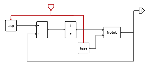

Diagram
ModuloCounter
