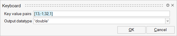

matkeys | Key value pairs | Defines a two-column matrix. The first column designates the key(s) and the second the corresponding output value(s). | Matrix of size Mx2 | |
typ | Output datatype | The datatype of the output. Supported types are: double, int8, int16, int32, uint8, uint16, uint32. | String | 'double' |
Port 2 | activation | input | 1 |
