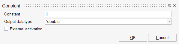

This block is a constant value generator.
    Constant
SignalGenerators
The Constant block generates a constant value. The output size and type are defined by the block parameter.
Constant_0
C
Constant
This parameter is a matrix of any type. The size of the matrix gives the size of the regular output port.
The constant(i,j) value is the component(i,j) value of the output port.
Matrix
typ
Output datatype
This parameter defines the type of the output. Supported types are: Double, Complex, int8, int16, int32, uint8, uint16, uint32, boolean, inherit.
'double'
'complex'
'int32'
'int16'
'int8'
'uint32'
'uint16'
'uint8'
'boolean'
'inherit'
externalActivation
External activation
externalActivation
