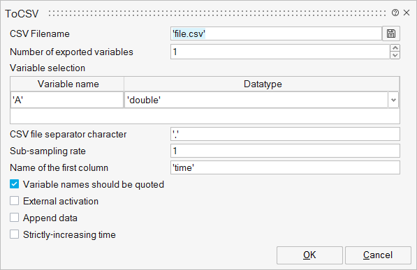

ToCSV
This block writes data into a CSV file. The first line of the CSV file must include the variable names, and the first variable name should be "time".
SignalExporters
fname | CSV Filename | String | ||
nin | Number of exported variables | Number | ||
inports | Variable selection | Structure | ||
inports/varname | Variable name | Cell of strings | ||
inports/vardatatype | Datatype | Cell of strings | 'double' | |
Separator | CSV file separator character | String | ||
SubS | Sub-sampling rate | Scalar | ||
addTime | Name of the first column | If the name is omitted, a time column will not be added to the CSV file. | String | |
quotedNames | Variable names should be quoted | Number | 0 | |
externalActivation | External activation | Number | 0 | |
append | Append data | Number | 0 | |
increasingTime | Strictly-increasing time | Select to create a strictly-increasing time sequence. | Number | 0 |
BufferSize | Buffer size | Scalar |
Port 1 | explicit | input | nin | |
Port 2 | activation | input | externalActivation |
