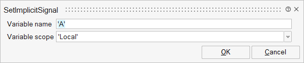

The SetImplicitSiganl block is used to connect implicit ports from a block to another without connecting them physically. It is used with a GetImplicitSignal block. A simple SetImplicitSignal block can send data to multiple GetImplicitSignal blocks, although a GetImplicitSignal can receive data from only one SetImplicitSignal. SetImplicitSignal transports its input data to its corresponding GetImplicitSignal block.
The "Variable Scope" parameter defines the scope in which the implicit signal is defined. For more information, please refer to the GetSignal block.
