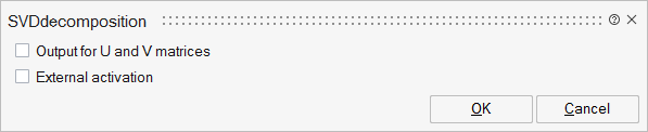

decomptyp
Output for U and V matrices
Defines the outputs. By default, the output is a vector S, composed of the singular values.
Turning on this parameter, the first output is a diagonal matrix S composed of the singular values and the other two outputs are the unitary matrices U and V.
