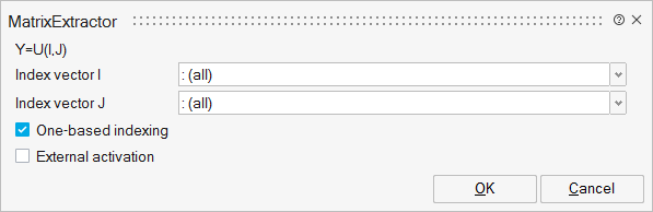

MatrixExtractor
Select elements of an input matrix.
MatrixOperations
Select elements of input matrix by specifying the index of first and second dimensions. The index can be specified as block parameter or externally fed with an optional input.
extractx | Index vector I | Structure | ||
extractx/x_selectall | : (all) | Select all rows. | Number | 0 |
extractx/x_vectorindex | Defined as parameter | Select rows by specified indices. | Number | 0 |
extractx/x_startingindex | i=I(1) defined as parameter | Select rows by specified starting index and output size. | Number | 0 |
extractx/x_startingindexdecreasing | i=I(1) defined as parameter (decreasing) | Select rows specified by the ending index and output size. | Number | 0 |
extractx/x_vectorindexport | Defined by input | Select rows by the indices provided externally. | Number | 0 |
extractx/x_startingindexport | i=I(1) defined by input | Select rows from starting index provided externally and output size. | Number | 0 |
extractx/x_startingindexportdecreasing | i=I(1) defined by input (decreasing) | Select rows specified by the ending index provided externally and output size. | Number | 0 |

extracty | Index vector J | Structure | ||
extracty/y_selectall | : (all) | Select all columns. | Number | 0 |
extracty/y_vectorindex | Defined as parameter | Select columns by specified indices. | Number | 0 |
extracty/y_startingindex | j=J(1) defined as parameter | Select columns by specified starting index and output size. | Number | 0 |
extracty/y_startingindexdecreasing | j=J(1) defined as parameter (decreasing) | Select columns specified by the ending index and output size. | Number | 0 |
extracty/y_vectorindexport | Defined by input | Select columns by the indices provided externally. | Number | 0 |
extracty/y_startingindexport | j=J(1) defined by input | Select columns from starting index provided externally and output size. | Number | 0 |
extracty/y_startingindexportdecreasing | j=J(1) defined by input (decreasing) | Select columns specified by the ending index provided externally and output size. | Number | 0 |

onebased | One-based indexing | To index a matrix, start from one when checked, start from zero when unchecked. | Number | 0 |
