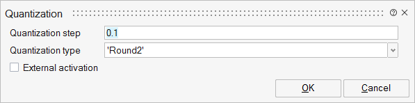

The Quantization block implements a quantizer. The output is obtained from the input according to a choice of methods : round , truncation , floor , ceil , or round2 methods. When fed with a smooth signal, it produces a stair-step signal.
step | Quantization step | Quantization step. Real scalar value. Default 0.1. | Matrix | |
method | Quantization type | Quantization method : round, truncation, floor, ceil, round2. | String | 'Round' |
