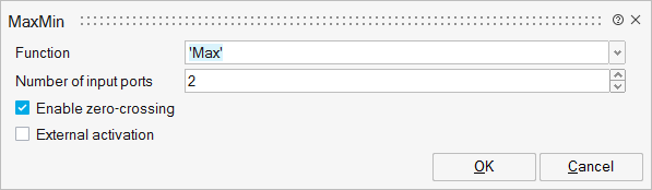

This block implements the minimum and the maximum functions. If the block has one input, the output is the min or the max of the entries of the input. If the block has more than one input, the output is obtained by applying the min or max function elementwise to the entries of the inputs.
MathOperations
The MaxMin block outputs either the minimum or the maximum element or elements of the inputs. You can choose the function to apply by selecting one of the choices from the Function parameter list.
Inputs are either scalar or vector.
mm | Function | Function type: min or max. | String | 'Min' |
nin | Number of input ports | Real value. | Number | |
zc | Enable zero-crossing | Used to enable the detection of zero crossings. | Scalar | 0 |
