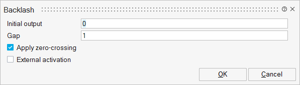

ini | Initial output | Initial output value is the center of the deadzone when simulation starts. | Matrix | |
gap | Gap | Width of the deadzone, or gap. Real value. Default 1. Scalar (applies to all the output) or matrix (of compatible dimension), each element defines the gap for each signal. | Matrix | |
zcr | Apply zero-crossing | Activate the zero-crossings detection. | Scalar | 0 |
