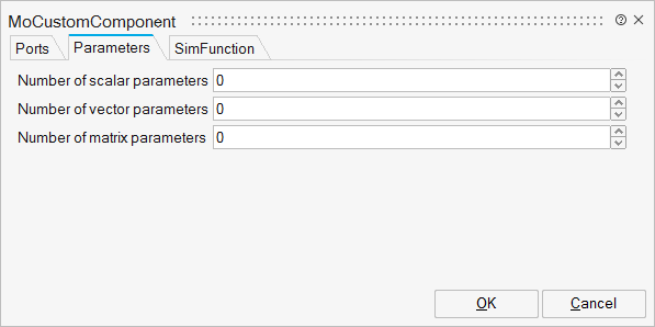

"Fixed" means that this is a constant and cannot change during simulation. In Modelica, this is expressed as: Parameter Real R=1;
"Fixed only at initialization" means that this value can change during simulation, but when the compiler tried to find the initial value this value must not change. In Modelica, this is expressed as: Parameter Real R(start = 1,fixed=true);
"Variable" means that this value can change during the simulation and during the initialization phase. In Modelica, this is epxressed as: Parameter Real R(start=1); or Parameter Real R(start=1,fixed=false);

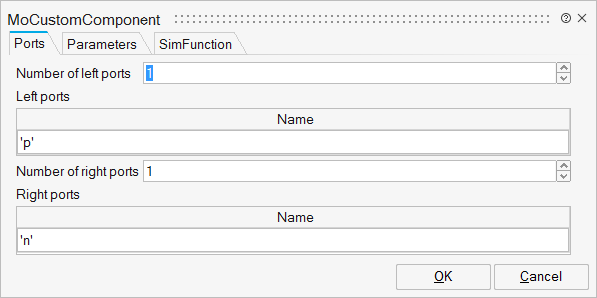

nin | Number of left ports | Number | ||
inports | Left ports | Structure | ||
inports/name | Name | Cell of strings | ||
nout | Number of right ports | Number | ||
outports | Right ports | Structure | ||
outports/name | Name | Cell of strings |
nparams | Number of scalar parameters | Number | ||
params | Parameters | Structure | ||
params/name | Name | Cell of strings | ||
params/value | Value | Cell of scalars | ||
params/typ | Type | Cell of strings | 'Fixed' | |
nparamsvec | Number of vector parameters | Number | ||
paramsvec | Parameters | Structure | ||
paramsvec/name | Name | Cell of strings | ||
paramsvec/value | Value | Cell of vectors | ||
paramsvec/typ | Type | Cell of strings | 'Fixed' | |
nparamsmat | Number of matrix parameters | Number | ||
paramsmat | Parameters | Structure | ||
paramsmat/name | Name | Cell of strings | ||
paramsmat/value | Value | Cell of matrices | ||
paramsmat/typ | Type | Cell of strings | 'Fixed' |

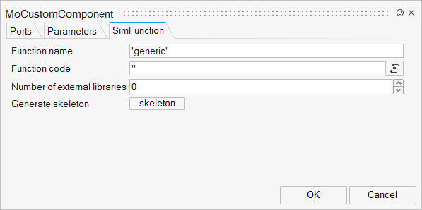

codename | Function name | Name of the model as it appears in the Function code. | String | |
code | Function code | Modelica code describing the behavior of the component. | String | |
nlibs | Number of external libraries | Number | ||
libs | Libs | Structure | ||
libs/path | Lib name | Cell of strings |
Port 1 | implicit | output | nout | |
Port 2 | implicit | input | nin |
