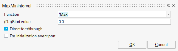

This block outputs the minimum/maximum of all past input values between two subsequent input events. A Function parameter list provides functions to apply.
Buffers
If the block is not activated by a discrete event, the block outputs the minimum/maximum of all past inputs values over the entire simulation time.
mm | Function | String | 'Min' | |
initial | (Re)Start value | At discrete event activation, the block output is reset to the Restart Value. | Matrix | |
depu | Direct feedthrough | Sets the direct feedthough of the block to true to ensure that when the block is called, the block inputs are up to date. If an algebraic loop occurs, deselect this option. | Number | 0 |
externalActivation | Re-initialization event port | If selected, the minimum/maximum is computed between two subsequent discrete events. Otherwise the minimum/maximum is computed over the entire simulation time. | Number | 0 |
