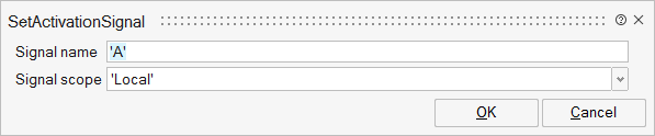

The "Signal Scope" parameter defines the scope in which the implicit signal is defined. For more information, please refer to the GetSignal block.Parameters
tag | Signal name | String | ||
tagvis | Signal scope | String | 'Local' |
Port 1 | activation | input | 1 |
