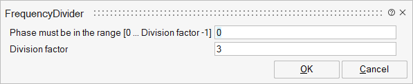

phase | Phase must be in the range [0 ... Division factor -1] | Real scalar value. Phase. | Scalar | |
div_factor | Division factor | Real scalar value. Division factor. In case the factor is non-integer, the floor rounding is applied. | Scalar |
