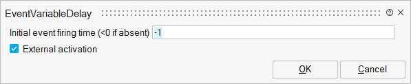

One event is generated on the unique output event port if "Initial event firing time" is larger than or equal to zero, if not, no event is generated.
initfir | Initial event firing time (<0 if absent) | Real scalar value. Time for the initial event firing. | Scalar | |
