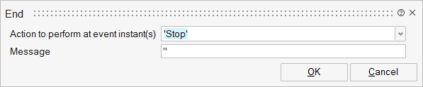

The End block can perform one of the following actions when activated:
- Stop: the block asks the simulator to stop the simulation and generates the message defined by the parameter "Message".
- Pause: the block asks the simulator to pause the simulation and generates the message defined by the parameter "Message".
- Restart: the block asks the simulator to restart the simulation process (evaluation, compilation and simulation).
- Error: the block generates an error. The simulator exits with the error defined by the parameter "Message".
- Message: the block generates the message defined by the parameter "Message".
job | Action to perform at event instant(s) | Action performed when the block is activated. | String | 'Stop' |
bmessage | Message | The message printed when the block is activated. When the action is a "Restart" this parameter is not used. | String |
