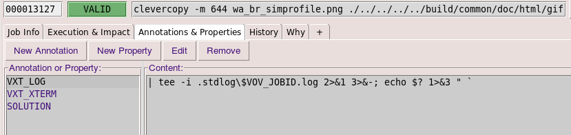

Changing the VXT_LOG property would allow for example for capturing the log in a different name file:
During vovbuild, the developer can modify a job after its definition by changing the property with something similar to:
vtk_prop_set $node_id VXT_LOG {| tee -i .stdlog\$VOV_JOBID.log 2>&1 3>&-; echo $? 1>&3 " `}
Once the developer is happy with the changes, it can be made the default for all further jobs in the build by setting "make(VXT_XTERM)" as in:
set make(VXT_LOG) {| tee -i .stdlog\$VOV_JOBID.log 2>&1 3>&-; echo $? 1>&3 " `}
