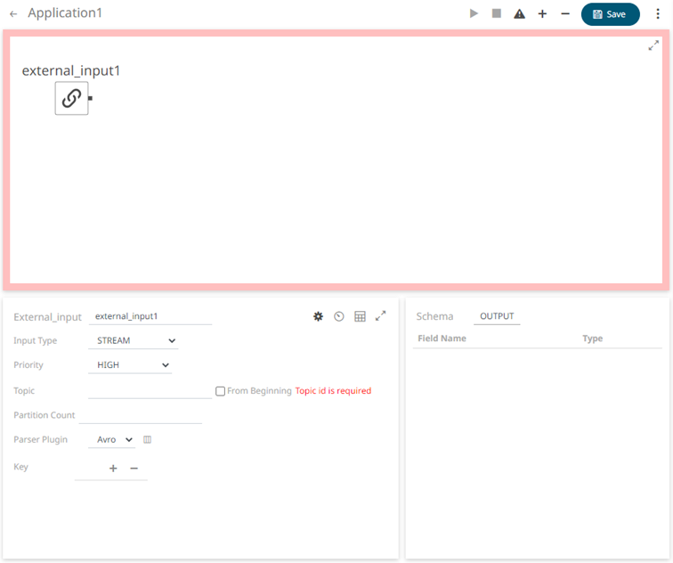

1.    In the Application page, click  and select External_input in the Context menu that displays.
The External Input node  icon displays in the Graph panel, as well as the properties to be defined in the Operator Settings panel, and the preview of the data in the Schema panel.
This operator serves as the initial source of the data in the application. The right (outbound) edge allows you to connect to other operators.
2.    In the Operator Settings panel, define or select the following properties:
Property
Externa Input
The ID of the external input operator.
Input Type
Select the input type: STREAM, TABLE, or GLOBAL_TABLE.
Priority
Select the priority of the node’s startup:
·         APPLICATION – running and successful completion of the node is critical in the application startup.
·         HIGHEST – highest priority but not critical.
·         HIGH (Default) – high priority but not critical.
·         STANDARD – standard priority.
·         LOW – low priority.
Topic
The stream of records or input you will be subscribed to.
From Beginning
Check to retrieve full history (from beginning to the latest) of the topic. If un-checked, only the latest messages after the application has started will be retrieved.
Partition Count
Enter the number of partitions for the Kafka topics that will be created for the External Input operator.
Partitions allow you to parallelize a topic by splitting the data in a particular topic across multiple brokers wherein, each partition can be placed on a separate machine to allow for multiple consumers to read from a topic in parallel.
NOTE: The External Input topic pulls the default partition count from the provided topic meta with generate schema call.
   NOTE
External_input, Input Type, and Topic properties are required.

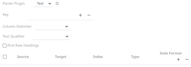

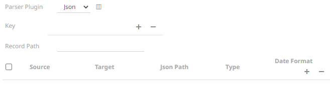

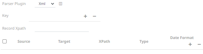

4.    Select the Parser Plugin:
·         Avro
·         XML
·         JSON
·         Text
If Text has been selected, confirm the Column Delimiter and Text Qualifier, and if the first row of the message includes column headings.
5.    Enter or select the following properties:
Property
Source
Target
The column name of the target schema.
XPath/Json Path/Index
Type
The data type of the column. Can be: BOOLEAN, DATE, DATETIME, DOUBLE, FLOAT, INT, LONG, STRING, TIME.
Date Format
Date/Time format when the data type is DATE, DATETIME, or TIME.
