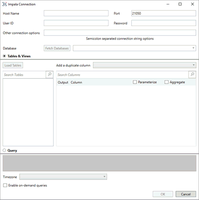

Launch the Connect to Data dialog and then select Cloudera Impala.
The Impala Connection dialog displays.
Provide the hostname, user ID, and password required to connect to the Impala database you wish to access. If the port you wish to use is different from the default port, change the default value to the correct one.
Specify other connection options if desired, making sure to separate individual connection strings by a semi-colon.

You can either:
click Fetch Databases to populate the drop-down list and select a database, or
enter the name of the database to which you want to connect.
The easiest way to select a table and/or view to load is by choosing from a set of predefined tables and views. To do so, ensure that the Tables & Views radio button is selected. If you wish to manually construct a SQL query to pull and load data, ensure that the Query button is selected. Once either a table or view or a query has been selected, the OK button at the bottom of the dialog is enabled.
Click Load Tables to load a list of predefined tables or views. This list can be filtered by entering an appropriate string in the Search Tables search box.
You can also add a duplicate column.
Select a table to display the available columns in the Search Columns list. Once a table has been selected, the Query text box is updated to reveal the results of a SELECT * FROM TABLE query. Any other selection made updates the Query text box accordingly.
Select the columns to add to your data table checking their corresponding Output Column box.
If you wish to parameterize a specific column, check the Parameterize checkbox and, in the dropdowns that display, select the desired value.
