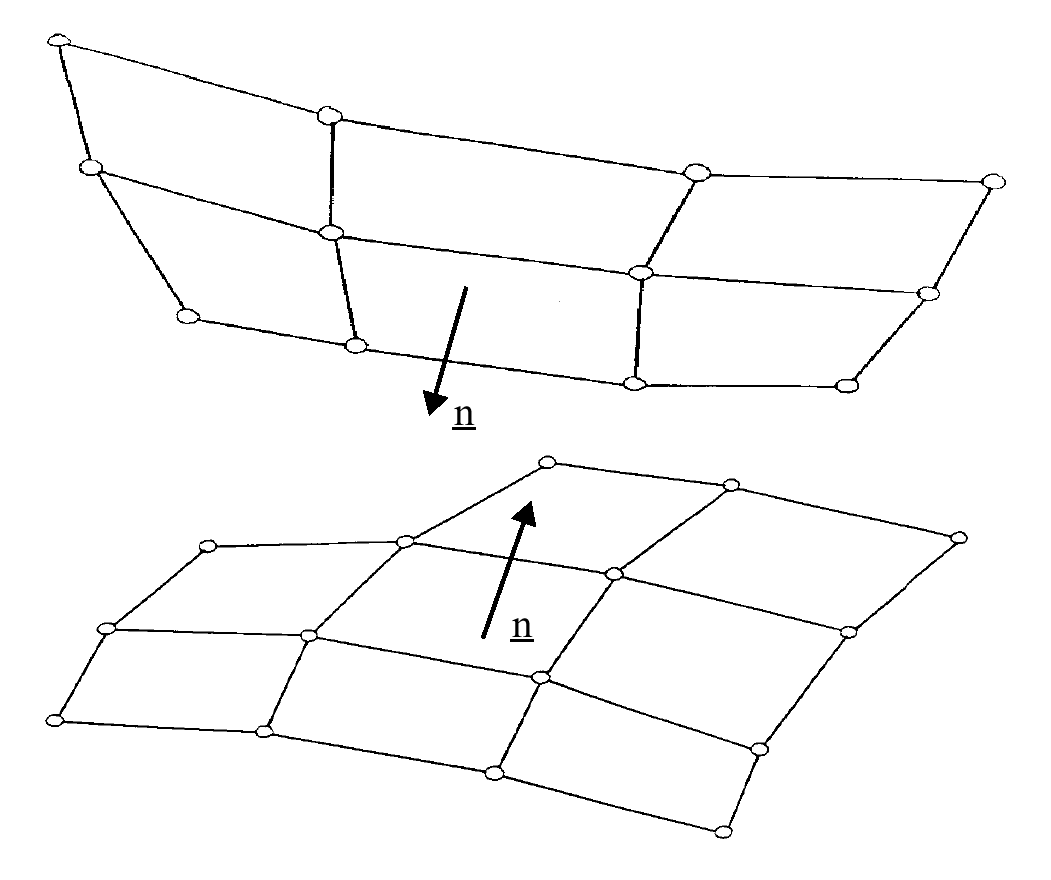

Figure 1. Surfaces 1 and 2 with Facing Normals

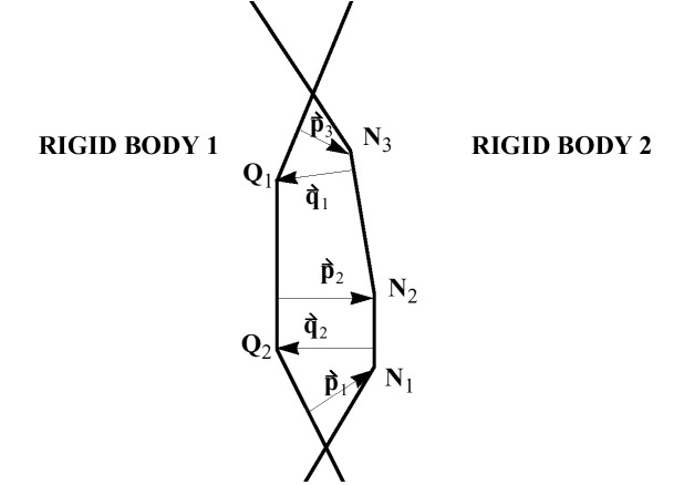

Figure 2. Especially Suited for Rigid Bodies
is the contribution to node of vector distributed on the segment penetrated by node .
