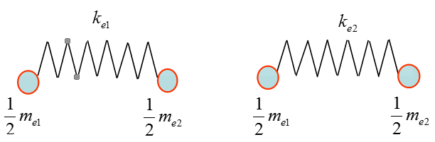

Interface
Interfaces have stiffness but no mass:
- Impact speed
