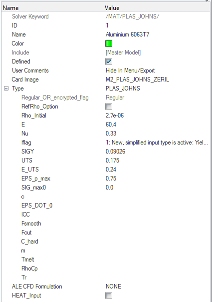

Create the Material
  1. In the Model Browser, right-click and select Create > Material.
  2. In the Entity Editor, for Name, enter Aluminum 6063T7.
  3. Set Card Image to M2_PLAS_JOHNS_ZERIL.
  4. Click Yes on the pop-up that warns of a card image change.
  5. In the Entity Editor, input the values, as shown in the following image.
  6. Click on the component, Tensile_coupon.
  7. In the Entity Editor, for Mat_Id, click twice on Unspecified and select the newly created material.
  8. Click OK.
    Figure 3. Material card of component Tensile_coupon

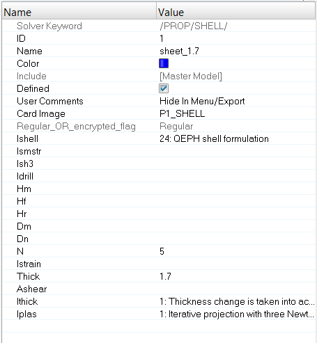

Create the Property
  1. In the Model Browser, right-click and select Create > Property.
  2. For Name, enter sheet_1.7.
  3. For Thick, enter 1.7. in the Value field corresponding to sheet thickness.
  4. In the Entity Editor, input the values, as shown in the following image.
  5. Click on the component, Tensile_coupon.
  6. In the Entity Editor, for Prop_Id, click twice on Unspecified and select the newly created property.
  7. Click OK.
    rd3500_02
    Figure 4. Property Card of Component Tensile_coupon

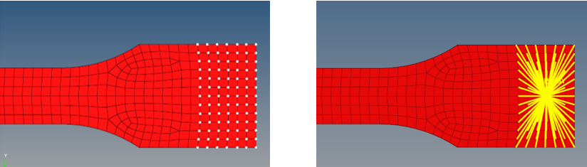

Create the Rigid Body
  1. In the Model Browser, right-click and select Create > Component.
  2. In the Entity Editor, for Name, enter Rigid Body.
  3. Set Card Image to None.
  4. From the Mesh pull-down menu, select Create > 1D Elements > Rigids.
  5. Set Secondary node(s) (nodes2-n) to Multiple Nodes.
  6. Set primary node to Calculate Node.
  7. Click Nodes and select the nodes as shown in Figure 5.
  8. Click create and return.
    Figure 5. Selection of the secondary nodes of the rigid body

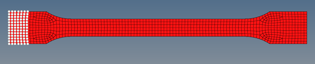

Create the Boundary Conditions
  1. Select View > Solver Browser, and right-click in the Solver tab area.
  2. Select Create > BOUNDARY CONDITIONS > BCS.
  3. For Title, enter constraint1 and right-click grnd_ID and click Create.
  4. Within the grnd_ID section, click on 0 Nodes beside Entity IDs, then Nodes.
    A nodes selection appears.
  5. Select the nodes, as shown below and click proceed.
    rd3500_nodes4
    Figure 6.
  6. Check the box beside DOF1, DOF2, DOF3, DOF4, DOF5, and DOF6 to fix all the degrees of freedom.

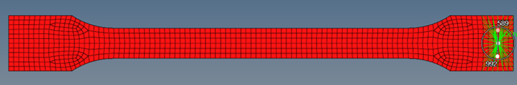

  7. Right-click BCS > Create to create a second constraint for the Rigid Body.
  8. For Title, enter constraint2.
  9. Right-click grnd_ID and select Create.
  10. Type “o” for options and select graphics > coincident picking to select the main node of the Rigid Body.
  11. Within the grnd_ID section, click 0 Nodes beside Entity IDs, then Nodes.
    A node selection appears.
  12. Select the node 990, as shown below and click proceed.
    Figure 7.
  13. Activate all degrees of freedom, except of DOF1, translation in the X-direction.

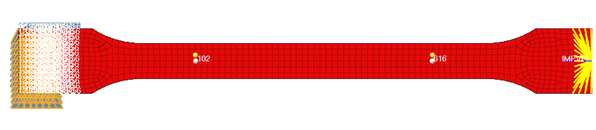

  5. From the Geom page, select temp nodes. Pick two nodes (yellow) with a distance of 80 mm .
    Figure 9. Temporary nodes with a distance of 80mm
  6. In the Solver Browser, right-click Create > TH > NODE.
  7. In the Entity Editor, for Name enter TH_Measuring_Nodes.
  8. For Entity ID’s select Nodes and select the nodes with the numbers 102 and 616 and click proceed.

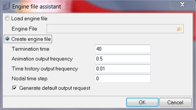

For this exercise the output request will be generated from the Engine file assistant, which is located in the Utility Browser.
  1. To start the Engine file assistant, select Tools > Engine File Assistant.
  2. Input the values, as shown below:
    rd3500_engine_file_assistant
    Figure 10. Settings and Output Variables for the Engine File

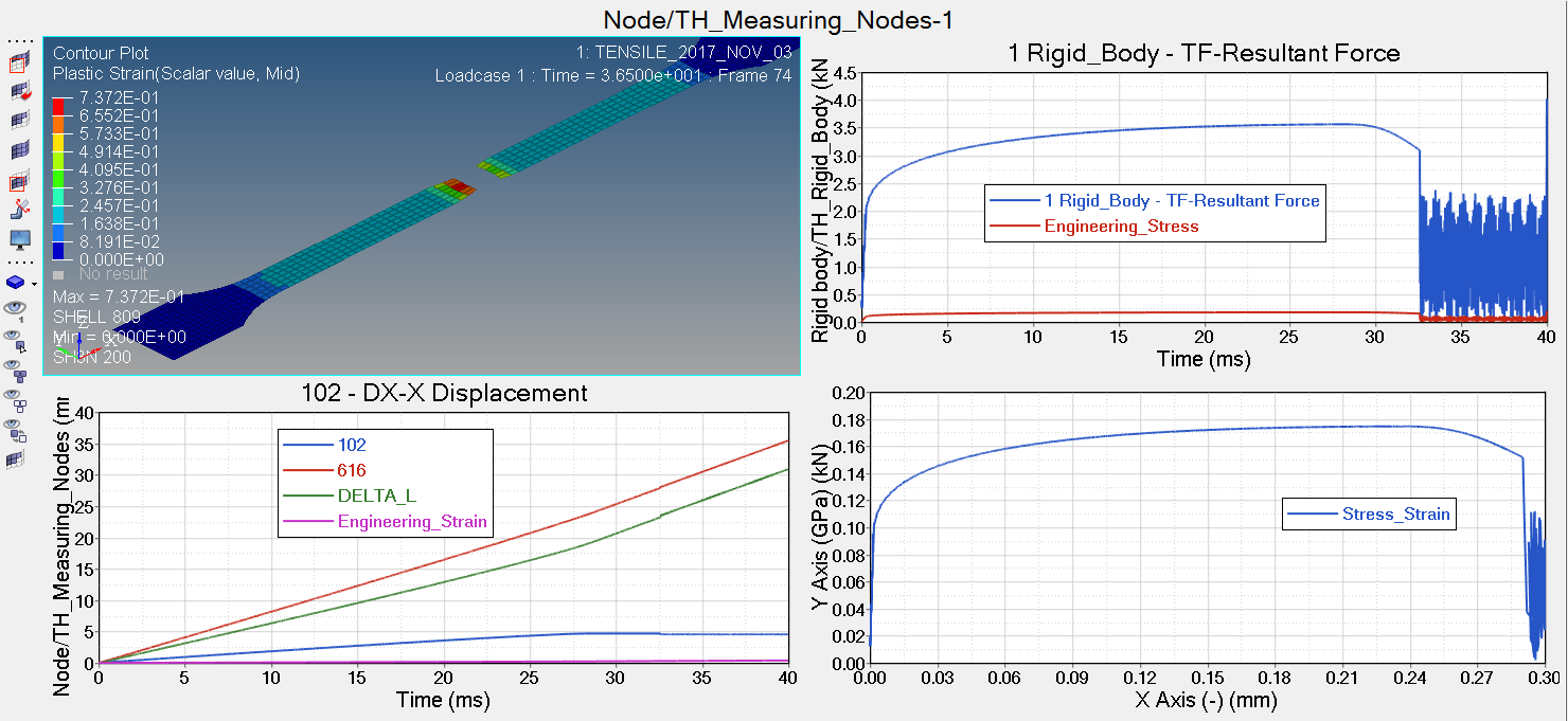

  9. Review the output files for this run and verify the results. See if there is any warning or errors on the .out files.
  10. Using HyperGraph, plot the displacement and stress curve (lower left and right) and the X-Force from the Rigid Body (upper right).
    Figure 11. Simulation Results of the Tensile Test
