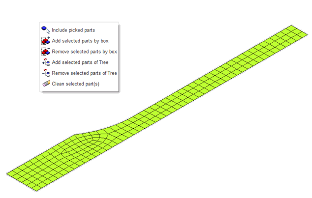

- For Title, enter Pshell.
- For Shell Thickness, enter 1.7.
In the bottom of the property window, right-click in the
Support entry box and select the Include
picked parts icon
- Select the part in the modeling window.
- Right-click to validate the selection.
- Click .

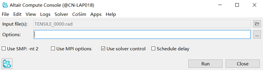

Open Compute Console from the Windows Start Menu

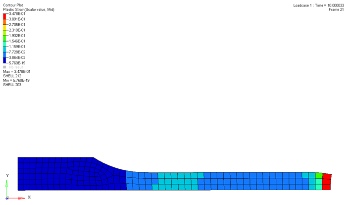

Expected Results

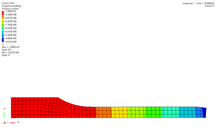

Figure 16. Total Displacement Contour (mm)
Figure 17. Plastic Strain Contour
