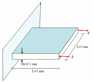

This example concerns the in-plane traction-comparison problem of an embedded plate subjected to two concentrated loads, as shown in Figure 2.

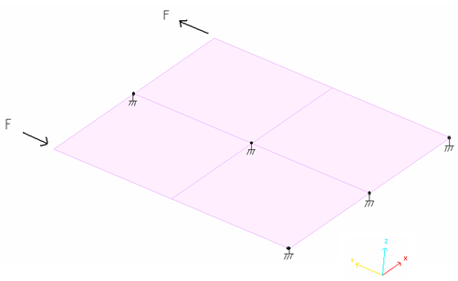

- Boundary conditions (/BCS)
The boundary conditions are such that the three nodes of a single side and the two middle ones are blocked, whereas the others are free with respect to the Y axis.
- Concentrated loads (/CLOAD)Two concentrated loads are applied on the corner points on opposing sides. They increase over time, as defined by the following function:
F(t) 0 10 10 t 0 200 400
Figure 1. Boundary Conditions and Loads

Figure 2. Geometry of the Problem

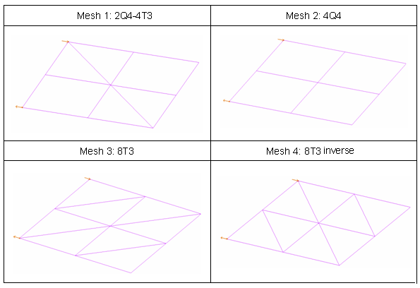

Model Method
- Mesh 1
- Two quadrilateral shells and four triangular shells (2Q4-4T3)
- Mesh 2
- Four quadrilateral shells (4Q4)
- Mesh 3
- Eight triangular shells (8T3)
- Mesh 4
- Eight triangular shells (8T3 inverse)
- QBAT formulation (Ishell =12)
- QEPH formulation (Ishell =24)
- Belytshcko & Tsay formulation (Ishell =1 or 3, hourglass control TYPE1, TYPE3)
- C0 and DKT18 formulations
Figure 3. Square Plate Meshes

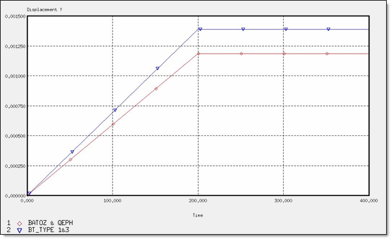

- vertical displacement of the node under the loading point

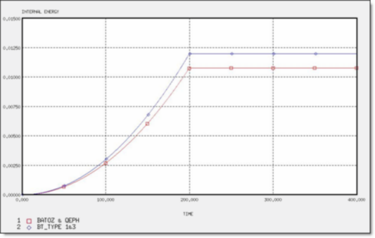

Energy Curves / Comparison for Element Formulations

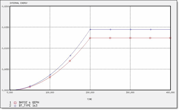

Figure 4. Internal Energy for 2 x Q4 and 4 x T3 Elements
Figure 5. Y Displacement for 2 x Q4 and 4 x T3 Elements
Figure 6. Internal Energy for 4 x Q4 Elements

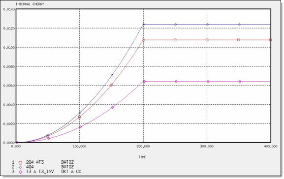

Figure 7. Internal Energy for Different Meshes

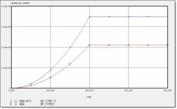

Figure 8. Hourglass Energy for Different Meshes
| Elastic Plate | 2Q4-4T3 | 4Q4 | 8T3 | 8T3_INV | ||||||
| QEPH | BT_TYPE 1 and 3 | BATOZ | QEPH | BT_TYPE 1 and 3 | BATOZ | DKT | CO | DKT | CO | |
| IEmax | 1.07 x 10-2 | 1.19 x 10-2 | 1.07 x 10-2 | 1.24 x 10-2 | 1.44 x 10-2 | 1.24 x 10-2 | 6.42 x 10-3 | 6.42 x 10-3 | 6.42 x 10-3 | 6.42 x 10-3 |
| HEmax | --- | 2.10 x 10-5 | -- | -- | 3.49 x 10-6 | -- | -- | -- | -- | -- |
| Dymax | 1.18 x 10-3 (Traction) | 1.38 x 10-3 (Traction) | 1.18 x 10-3 (Traction) | 1.24 x 10-3 | 1.44 x 10-3 | 1.24 x 10-3 | 6.42 x 10-3 | 6.42 x 10-3 | 6.42 x 10-3 | 6.42 x 10-3 |

In the case of elastic flat plate modeling, when the loading is in-plane, the shell elements are reduced to become a membrane if the loads applied do not cause buckling.
- The quadrilateral shell elements QEPH and QBAT have the same in-plane behavior.
- The different types of hourglass formulations in the BT shell elements lead to the same results, as there is no out-of-plane deformation and the material is supposed to be elastic.
- The three in-plane behaviors of the DKT18 and T3C0 Radioss triangles are exactly the same, as both of the elements are used for the same membrane formulation.
- The triangles are stiffer than the quadrilateral elements and do not provide good results, especially when the mesh is coarse.
