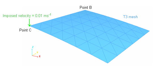

A shallow cylindrical roof, pinned along its straight edges, upon which an imposed velocity is applied at its mid-point.
Units: mm, ms, g, N, MPa
Geometrical data are indicated in Figure 1, with the following dimensions:

rad_ex_fig_2-7
Figure 2. Description of the Problem (one quarter of the shell is modeled)

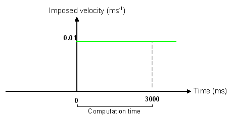

The imposed velocity is considered using the implicit method. Thus, the constant input curve is converted into an imposed displacement according to the computation time.
rad_ex_fig_2-8
Figure 3. Imposed Velocity Curve

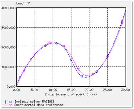

Only a quarter of the total load is applied due to the symmetry. Thus, force Fz of the rigid body as indicated in the Time History must be multiplied by 4 in order to obtain force, P.
Figure 4 represents the characteristic load displacement curve for a snap-thru. This diagram plots the reaction at point C of the shell as the function of its vertical displacement. The implicit results are compared with the experimental data.
rad_ex_fig_2-9
Figure 4. Load P versus Displacement of Point C
For a time step equal to or less than 10 ms (maximum value set in the implicit /IMPL/DT/STOP option), agreement with Radioss is achieved, with good results obtained using the reference. Accuracy is improved by decreasing the maximum time step, even though the CPU time is increased.

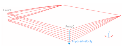

Figure 5. Deformed Configurations during the Snap-thru

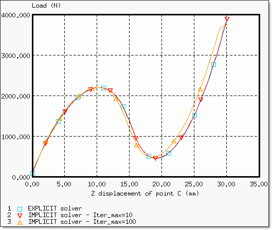

Implicit and Explicit Comparison Results
The load displacement curves achieved through implicit computations (time step limit set to 10 ms) and explicit computations are very close. A maximum time step of 100 ms does not allow the nonlinear path of the load displacement curve to be described accurately. However, the final static solution is correct.

Comparison of the computation time between the explicit and implicit (maximum time step set to 10 ms) approaches is shown in Table 1:
Table 1. Computation Time
  Implicit Solver Explicit Solver
Normalized CPU 1 2.45
Cycles (normalized) 1 237
In comparison with the implicit computation, which uses a maximum time step of 10 ms, the saved CPU time using a maximum time step fixed at 100 ms, approximately corresponds to factor 4.
