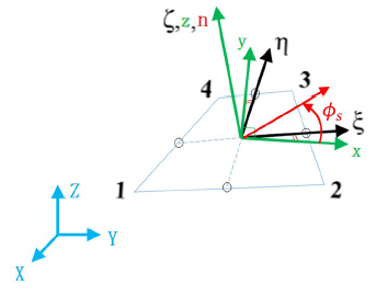

| Orthotropy angle to element skew. 5
(Real) |

- For Coordinate system in 3-node shell element, refer to Radioss Coordinate System in the User Guide.
- If def_orth = 1, the
orthotropy angle,
is only used in /PLY
and /PROP/TYPE19 (PLY).
