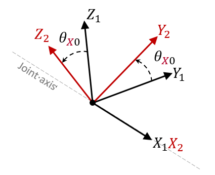

- If Skew_ID2 is defined, rotation angles of
the joint are initialized according the rotation between Skew_ID1 and
Skew_ID2.
Values of the initial angles can be check in the Starter output file.
For revolute (TYPE2), cylindrical (TYPE3) and planar (TYPE4) joints only
can be initialized. The first axis of
Skew_ID1 and
Skew_ID2 must
be parallel.
Figure 1. Computation of Initial Rotation Angle for Revolute Joint (TYPE2) - If Skew_ID2 is non-zero and Skew_ID1 =0, then Skew_ID1 is the global coordinate system.
