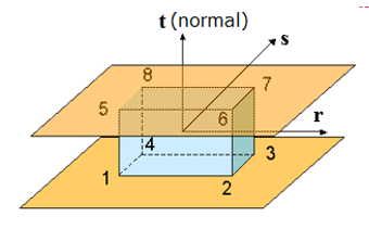

- Orientation of the
elementThe orientation of the element normal direction (t-axis) is different than a typical solid element and instead is similar to a shell element. The normal direction t is constructed from bottom (nodes 1-2-3-4) to the top (nodes 5-6-7-8). Due to this difference, pre-processors will show the element normal of connection elements in s-axis direction which corresponds to the typical solid element.
Figure 1.The element local coordinate system is constructed in the mid-plane section between the bottom (1-2-3-4) and top (5-6-7-8) faces.
Figure 2.The element has four Gauss integration points placed in the mid-plane section defined by points 1a, 2a, 3a, and 4a. These four points (1a, 2a, 3a, and 4a) lie midway between the bottom and top face nodes, and the orientation of the local coordinate axes (r-s-t) is the same as that of shell elements and t-axis is assume to be directed from bottom face to top face.
