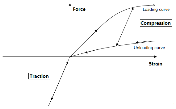

- Spring forces are
calculated using loading and unloading functions for different rates.
- The rate is determined and the maximum loading force as well as the minimum unloading force is determined by interpolation from the input curves.
- The behavior between the loading and unloading curves is linear, using Kmax value as the spring stiffness.
- For both loading and unloading, input curves should be defined in order of strictly increasing strain rate values.
- To describe spring compression behavior, input curves Force(strain) should be strictly positive.
- In traction, spring behavior is linear with stiffness equal to
Kmax.
- Lscale is used only when the Ileng =0 (abscissa unit is length); otherwise the default value =
1.
