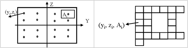

Figure 1. - The cross-section of the element is
defined using up to 100 integration points (Figure 2). The element properties of the cross-section,
i.e. area moments of inertia and area, are computed by Radioss as:
(1) (2) (3) - It can be used for deep beam cases (short beams). The use of several
integration points in the section allows to get an elasto-plastic model in which von
Mises criteria is written on each integration point and the section can be partially
plastified contrary to the classical beam element (TYPE3).

Figure 2. Cross-section Definitions in the Integrated Beam - For rectangular section: L1 is the rectangular size in Y-direction of the local beam coordinates system and L2 is the rectangular size in Z-direction. For circular section: L1 is the radius.
