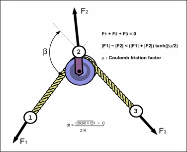

- This property is modeled using
a 3 node /SPRING element where node 1 and node 3 are the ends of the
rope and node 2 is the pully location.
Figure 1.Once node 1 slides to node 2 locking occurs as if there is a knot at node 1 that cannot move through the pully.
