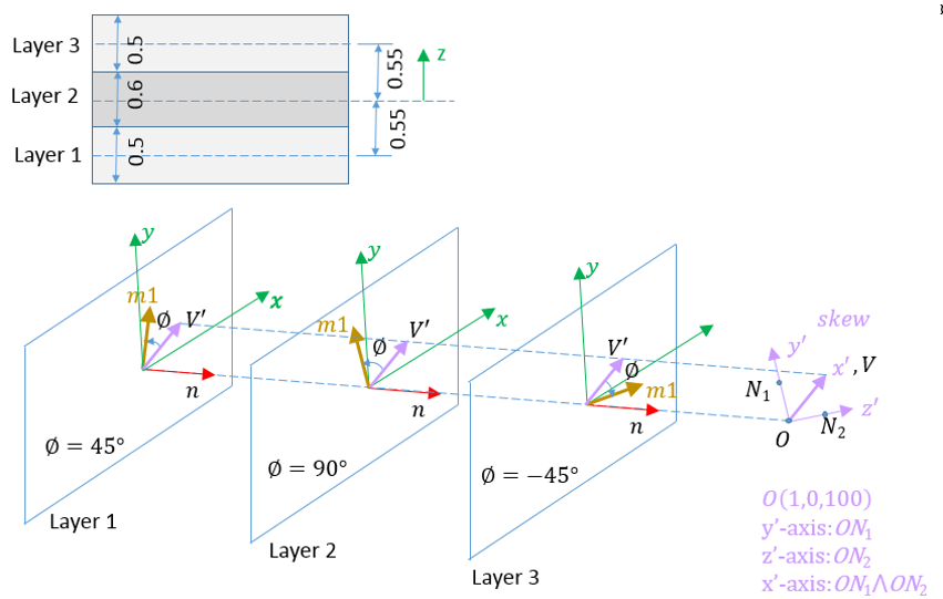

Example
#RADIOSS STARTER
#- 1. LOCAL_UNIT_SYSTEM:
/UNIT/2
unit for prop
# MUNIT LUNIT TUNIT
kg mm ms
/SKEW/FIX/1
New SKEW 1
# OX OY OZ
1.0 0 100.0
# X1 Y1 Z1
0 0 1
# X2 Y2 Z2
0 -1 0
#- 2. GEOMETRICAL SETS:
/PROP/SH_SANDW/2/2
SH_SANDW example
# Ishell Ismstr Ish3n Idril Pthick_fail
12 0 0 0 0
# hm hf hr dm dn
0 0 0 .1 .1
# N Thick Ashear Ithick Iplas
3 1.6 0 1 1
# Vx Vy Vz Skew_ID Iorth Ipos
0 0 0 1 0 0
# Phi t Z mat_ID F_weighti
45 .5 0 1 0
90 .6 0 2 0
-45 .5 0 1 0
#enddata
