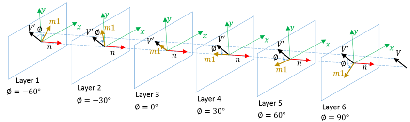

Example
prop_type10_example
Figure 1. 6 Layers with Different Material Direction (Fiber Direction)
#RADIOSS STARTER
#-  1. LOCAL_UNIT_SYSTEM:
/UNIT/2
unit for prop
#              MUNIT               LUNIT               TUNIT
                  kg                  mm                  ms
#-  2. GEOMETRICAL SETS:
/PROP/SH_COMP/2/2
SH_COMP example
#   Ishell    Ismstr     Ish3n    Idrill
        12         0         0         0
#                 hm                  hf                  hr                  dm                  dn
                   0                   0                   0                  .1                  .1
#        N                         Thick              Ashear              Ithick     Iplas
         6                           1.8                   0                   1         1
#                 Vx                  Vy                  Vz
                   1                   0                   1
#              Phi_1               Phi_2               Phi_3               Phi_4               Phi_5
                 -60                 -30                   0                  30                  60
                  90
#enddata

  8. Orthotropy in local coordinate system
    • Orthotropic direction defined with global vector V (components defined in Line 6) and angle ϕ i (angle in degree) for each layer.
    • Projection of vector V on shell element plane becomes the vector V . Then for each layer, the orthotropic direction (direction 1) is vector V turn ϕ i degrees (turns positive direction coding to shell normal n ).
      prop_type9_v10
    • In case of reference metrics, the orientation for directions of anisotropy must be defined with the reference geometry, not the initial one.
    • Layers are overlying one by one from bottom to top.
