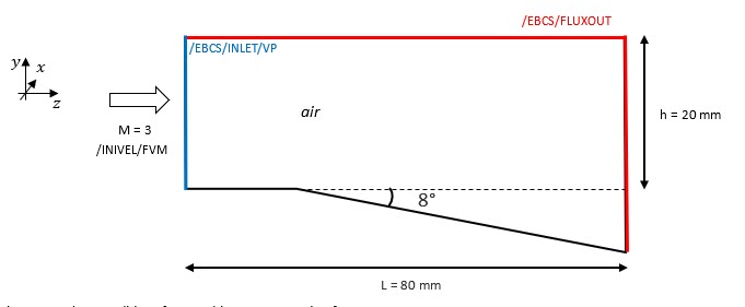

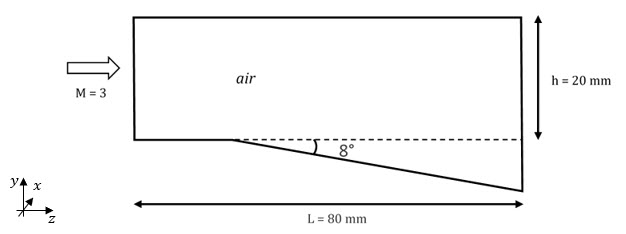

A supersonic wind tunnel (80 mm length, 20 mm height) is filled with a supersonic flow (M=3) of air.
The lower wall includes a convex corner with a downward angle of 8 degrees.
Figure 2. Problem Description for the Prandtl-Meyer Expansion Fan

Figure 3. Boundary Conditions for Prandtl-Meyer Expansion Fan
When using /MAT/MULTIFLUID, the default boundary conditions are sliding walls.
A non-reflecting boundary is defined using /EBCS/INLET/VP. Input density and pressure are defined for the air in the multi-material law.
A non-reflecting boundary is defined with /EBCS/FLUXOUT.

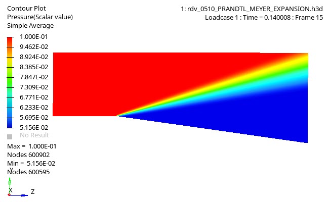

Figure 4. Pressure Contour of Fluid Domain

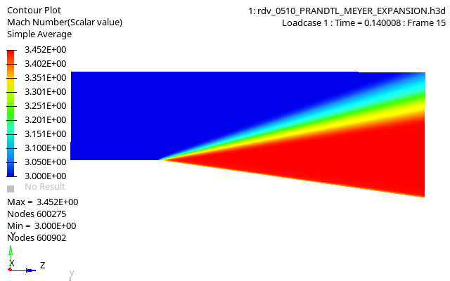

Figure 5. Mach Number Contour of Fluid Domain

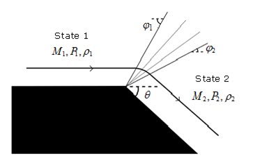

Analytical Analysis
Figure 7. Deflection of a Supersonic Flow through an Expansion Fan
| Initial State | Final State | |
| Mach number | 3 | 3.4519 |
| Pressure [MPa] | 0.180 | 0.0516 |
| Mass density | 1.225E-06 | 7.6337E-07 |

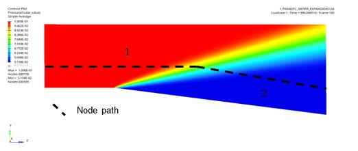

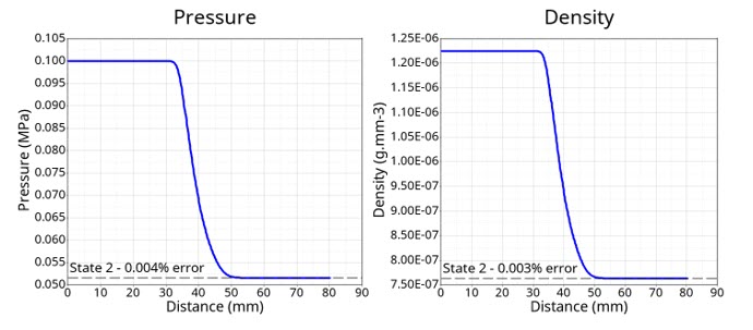

Results Comparison with Analytical Values
Figure 8. Two Possible Node Paths Going Through Every State of the Flow
To draw node paths, the elemental results visible on the animation have to be averaged at the nodes, using the averaging method simple in HyperView.
Figure 9. Pressure and Mass Density Spatial Profile in Steady State. with the value of the relative error to the analytical value
| Values | Analytical | Simulation | Percent Error |
| Mach number | 3.4519 | 3.4518 | 0.004 |
| Pressure [MPa] | 0.05157 | 0.05158 | 0.004 |
| Mass density | 7.6337E-07 | 7.6334E-07 | 0.003 |
