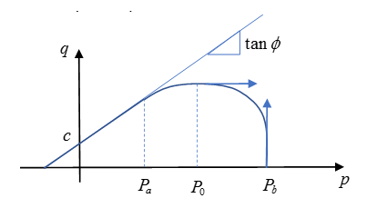

- The yield surface is defined
as:
(1) Where,
if
if
Where,- p
- Pressure
- q
- von Mises stress
- c
- Material cohesion
- P0
- Pressure, where
- pb
- Cap limit pressure
Figure 1.In this material, yield surface and failure surface are the same.
