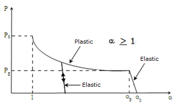

- If
the behavior is elastic, and if
describes plastic region.
In the elastic region, the change of porosity α with pressure is reversible.
In the plastic region, the porosity α is assumed to depend on pressure as described below:(3) Where,- Porosity where pressure reach the elastic compact pressure
- Pressure reaches the solid (matrix) compact pressure
- Iinitial porosity
